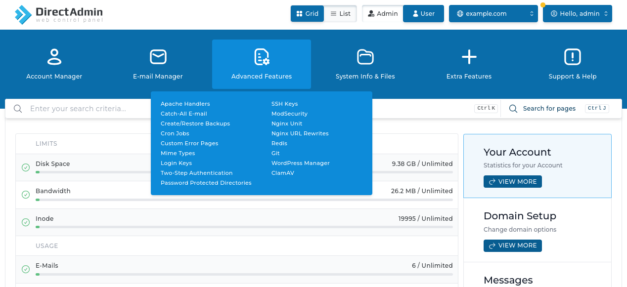

Standard layout update evolution improved
The Standard layout received an update:
- Improved style for User/Admin access level switch buttons.
- Improved style for the menu Grid/List mode switch buttons.
- User menu style is unified with the domain selector and header buttons.
- The domain selector is always visible.
- The layout is now more mobile-friendly.
