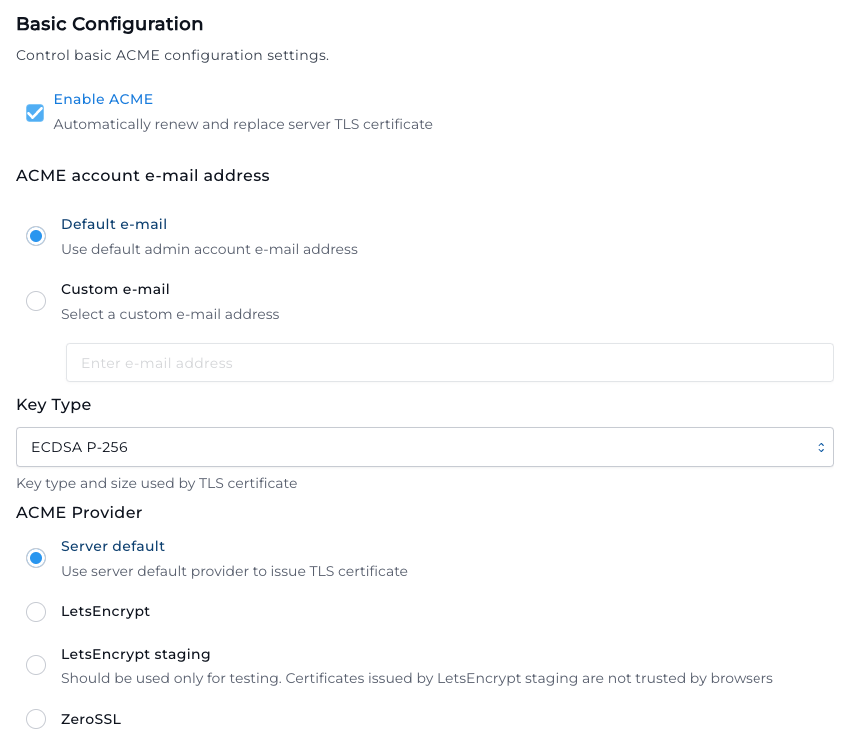

Server TLS ACME configuration page evolution new
A new page has been added to Evolution. It can be accessed on admin level in Server Manager -> Server TLS Certificate page and clicking the Settings button.
Page features the ability to control basic configuration needed to automatically issue and renew server certificates using ACME protocol. It also allows control of what domains will be part of the TLS certificate as well as the option to configure an external DNS provider for wildcard certificates.

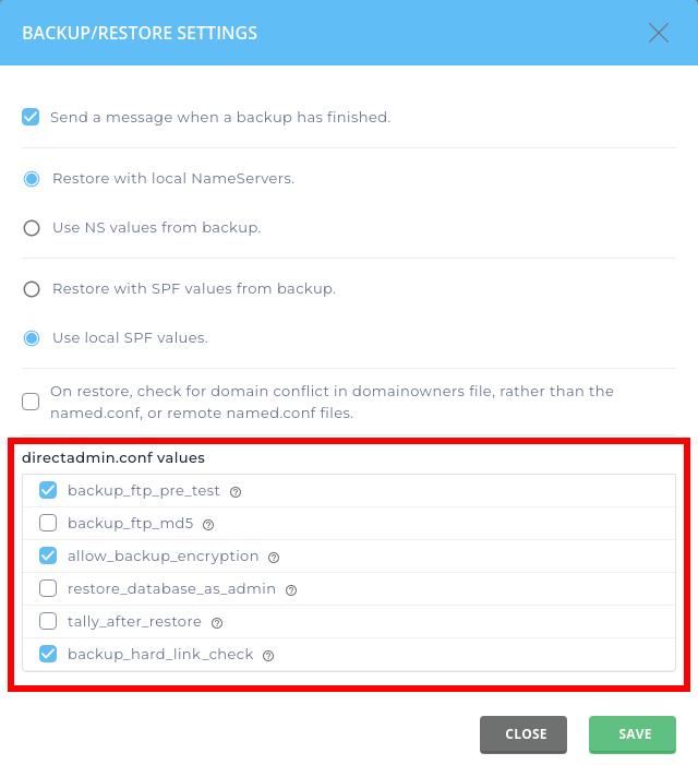

Backup settings are saved immediately evolution improved
In previous DirectAdmin versions, updating backup-related configuration settings used to take effect after a minute from the time settings were saved (action was performed using a task queue).
This sometimes caused confusion when settings are checked immediately after updating because old settings would be shown.
Starting this release, setting changes will be applied immediately.

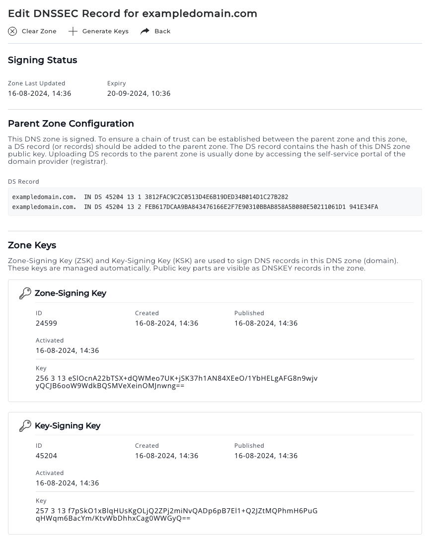

DNSSEC page redesign evolution improved
The dns security page (accessed from either user level's DNS Management or admin/reseller level's DNS Administration pages) has been redesigned to add more clarity as to what information is provided on the page. Some other minor improvements include the addition of a copy button for the DS record and a warning window popup when "Clear Zone" is clicked.
Below is an example of what the page looks like now:
