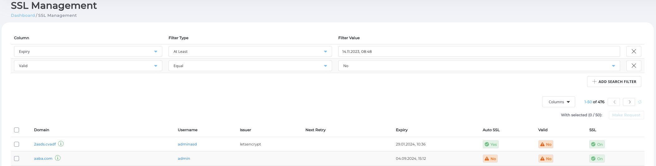

Admin SSL UI evolution improved
Updated Admin SSL UI:
- Added
Expiryas a column to the table. - Added
Expiryinto the list of possible filters, allowing to filter domains by certificate expiration date. - Added
Validas a filter. - Fixed issue with Issuer filtering, where incorrect comparison data were sent to the backend.

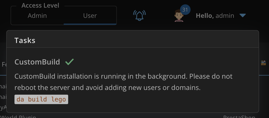

Custombuild finished tasks evolution improved
Previously only indication that task finished was that the notification at the bottom right of the screen would disappear and a loading icon next to task name would disappear. With this change, after all active custombuild tasks finish, the bell icon will no longer pulsate and a checkmark will be added next to the name of the task.

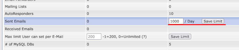

Option to change sent emails limit fixed
Input field for changing daily sent email limit were not visible in the Enhanced skin.
