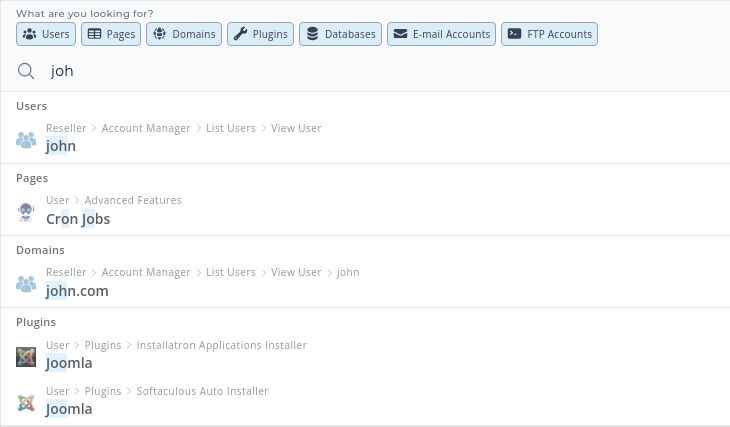

Advanced global search for all layouts evolution new
A new global search bar is added to all Evolution skin layouts. It unifies and improves how the search works. Notable changes:
- Search targets (users, domains, menu entries, etc.) can be easily turned on or off inside the search box.
- The search results are grouped by the search target.
- The matching part of the search is highlighted on the search results. This makes it easier to understand why and how the result matched the search string.
- The search results for pages include a page location in the menu.
- Too many results from a single search target is collapsed with an option to show all results. This avoids results from a single target overwhelming the results from other targets.

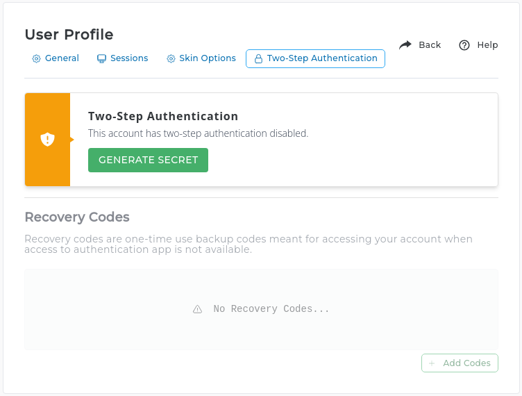

Updated two-step authentication page evolution improved
The page for enabling and managing two-step authentication is updated. The page can now be found as a new section in the User Profile page.
Key improvements:
- It will no longer be possible to enable it without providing a correct code from the Authenticator app.
- Once enabled, the two-step authentication page will no longer show the authentication secret when the page is visited again.
- An option to send a notification on two-step authentication failures is now grouped with other notification settings in the General section.
- Recovery codes will be automatically generated after two-step authentication is enabled.

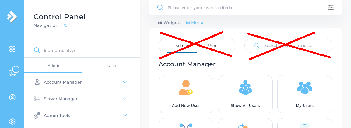

Removed search from Refreshed layout menu grid evolution removed
The refreshed layout dashboard in menu grid mode will no longer have a quick search bar and user-level switch at the top of the page.
Access level switching should be performed in the right-side menu.
