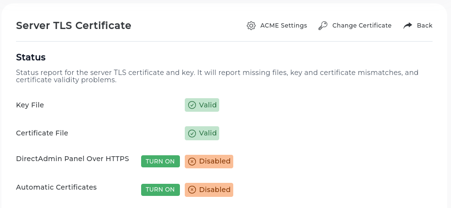

Using the free "Let's Encrypt" tool to secure Port 2222 via the Hostname
As of DA 1.50.0, we've added a new feature that allows you to make use of Let's Encrypt, a tool offering free basic SSL certificates.
We've written the script in such a manner that you can also set up SSL for your hostname and all services in one simple command for your hostname e.g.,:
/usr/local/directadmin/scripts/letsencrypt.sh server_cert
which will also install the new cert/key/ca files in all respective global places for Apache, Dovecot, Exim, FTP, and DirectAdmin.
DirectAdmin should be protected with SSL in 1min when the command finished.

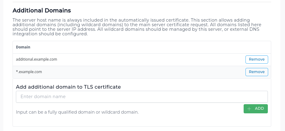

I want a multi-domain certificate for my hostname/mailserver using Let's Encrypt
Exim and Dovecot do support multi-IP ssl certificates, but their setup can be a little bit tricky to try and maintain.
With Let's Encrypt, we can set up multi-domain certificates for the hostname, and mail domains, all in one value, to make managing SSL for mail a little simpler.
/usr/local/directadmin/scripts/letsencrypt.sh server_cert `hostname -f`,mail.domain.com,smtp.domain.com,www.domain.com,domain.com

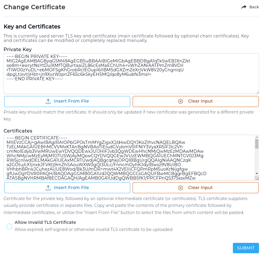

Setting up DA (port 2222) with a commercial SSL certificate
This guide will detail the configuration of SSL certificates for the server's services, such that the SSL is installed on the hostname and used for DirectAdmin, Exim, Dovecot, and FTP.
If you already have your own certificate and key, then paste them into the following files:
- certificate:
/usr/local/directadmin/conf/cacert.pem
- key:
/usr/local/directadmin/conf/cakey.pem
Ensure that ssl and certs are enabled in directadmin.conf
file with:
/usr/local/directadmin/directadmin config | egrep "^ssl=|^cacert=|^cakey="
Sample output:
ssl=1
cacert=/usr/local/directadmin/conf/cacert.pem
cakey=/usr/local/directadmin/conf/cakey.pem
But these can be changed as needed.
DirectAdmin needs to be restarted after any changes to the directadmin.conf, please follow this guide for changes.
If you also have a CA Root Certificate, this can be specified by adding:
carootcert=/usr/local/directadmin/conf/carootcert.pem
into the directadmin.conf
(won't exist by default), and then by pasting the contents of the caroot cert into that file.
