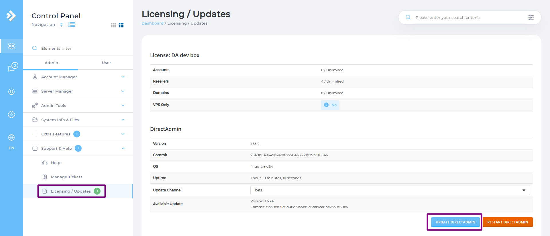

Manual update using GUI ​
Update can be triggered from the GUI in the Licensing / Updates section. If a new DirectAdmin version is available you will see an Update Directadmin button available.
